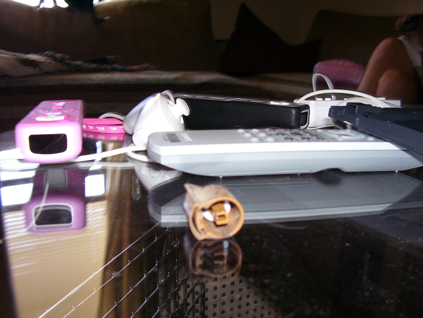

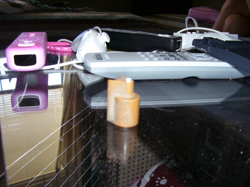

Okay, WTF!?!? I went out there today, found the brown connector by the passenger side strut tower and unpluged this from it.
I then started the car, she ran great! No missfire, no hesitation, no ruff idle, no knock. Timing was at 17%. Both O2 sensors were cycling properly.
I want to drive her, but I apparently hit a heater hose or something along those lines while messing around with the PTU and coil packs over and over and am leaking a good amount of coolant when the car is on. So I need to fix that before I drive her and really find out if that brown plug truly fixed my problems.
Tiffany and I are going out today, but I might be able to work on the car later on today.
I still can't believe what happened.
So, is this brown cap a ground of sorts??
I'll keep everyone updated if this really fixed the problem or not as I know more.
But please, discuss the evil brown plug.

Thats just a cap with no metal connection in it at all. If that fixes yur probem i may have to stop being athiest

Re: CEL 36
[quote=""J-Groove""]So, is this brown cap a ground of sorts??
But please, discuss the evil brown plug. [/quote]
There you go. Mystery solved. :)
That brown plug is the cap for the timing connector that Grey Haze was talking about.
When the plug is grounded it sets the ECU into mode where you can set the timing manually and the idle. You're not supposed to adjust the BISS screw without first grounding that little plug.
Oh and nice legs. ;)
Re: CEL 36
come on, you know you want to believe in God, just don't take the bible word for word, it was rewritten by to many men in power over the ages.
Haha, well the plug fixed it, but only probably because it moved the wire just enough.
I'm going to do as Grayson suggested and splice it at pin 104 on the ECU.
