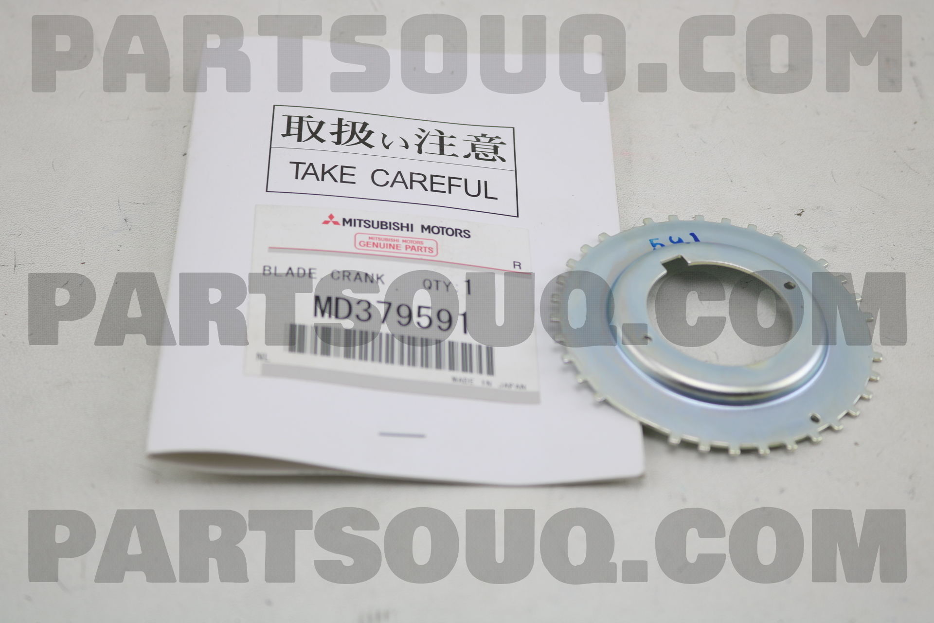

Is there an option for a 32 tooth wheel? 6G75 uses that. The sensor is just a mag pickup. It bolts into the same place as a 6G72 hall effect sensor.

We already talked about that crank trigger. Pretty sure that won't work as it has missing teeth in different locations (2 missing at 1/4 TDC, 1 at 2/5 TDC, 1 at 3/6 TDC) and Infinity just wants one pin missing at cylinder 1 TDC only (so has to be a single tooth cam trigger). If it was just 36 evenly-spaced teeth on that crank wheel, then we'd be good to go with just modding a stock cam trigger disc by removing the extraneous teeth.
