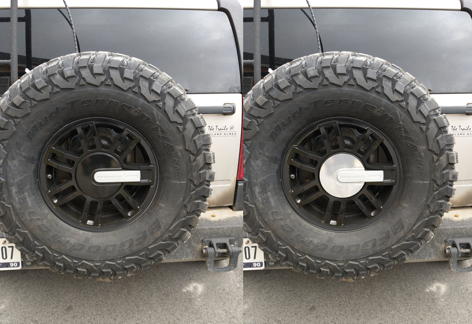

:chin:
Posts: 12485
Re: That V8 tho...

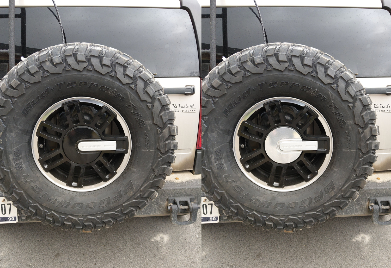

Coming off well? Is that chrome underneath or the aluminum?
Re: That V8 tho...
Unfortunately this is only photoshop. Thinking about painting the older wheels black and keeping the center chrome of the new.
Re: That V8 tho...
[quote=""vegasidol""] :chin:
With black edge. That's what the current wheels look like, just solid, not split spoke.
