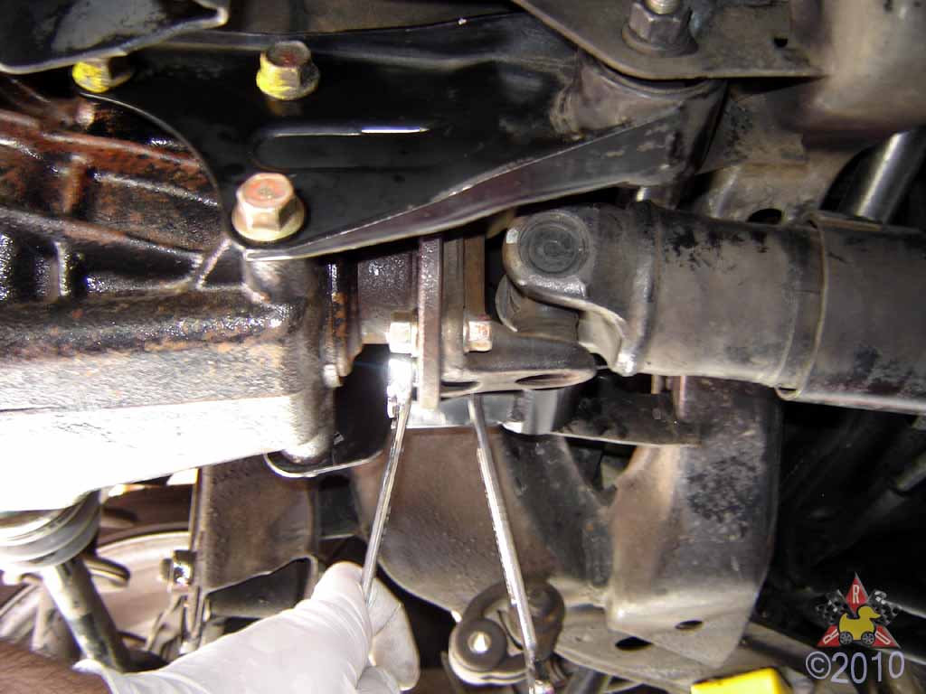

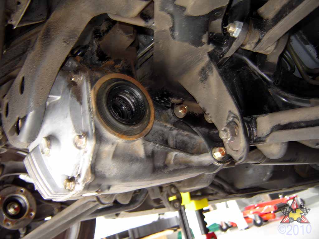

Honestly, I think this whole design is flawed. He's holding up the weight of the diff using long tubes connected far outboard from the diff. Basically the diff is at the long end of two levers - those tubes are going to either break off the subframe mounts at the end, at the plate mounting them to the diff, or be bent in the middle.
Compare to the stock rear hanger, which is a really beefy part and has a lot of reinforcement bends in it to box in the structure.
He's also holding the front of the diff from the sides, instead of hanging it from the front, so this whole design is missing a major triangulation point there. There's nothing solid preventing the diff from moving fore/aft at all.
Compare to the stock front plates which are mounted straight forward and connected to the subframe to prevent fore/aft movement, as well as resist torsional stress (to some extent - though the rear mount provides much more torsional resistance):
