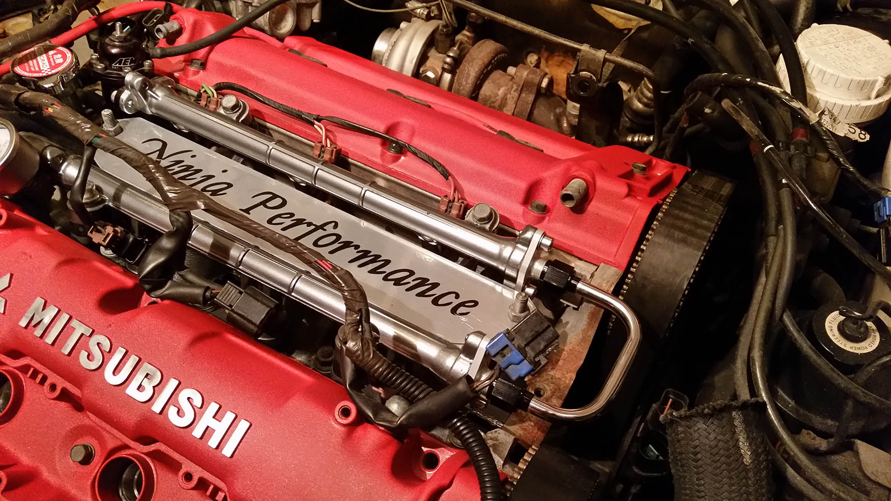

Great did an awesome job.
Re: Spyder Build Thread
Yeah, that red sure looks nice!
Posts: 12488
Looks great. Now ditch those rusty bolts.

Funny how fixing up one thing makes something else stick out like a sore thumb.
[quote=""Hans_GZP""] I think I had Em reach her bitch paws in there to get the nuts off. [/quote]
"Ask not what you can do for your country - ask what your country can do for you." - The gimme generation
[quote=""mjannusch""]Yeah, that red sure looks nice![/quote]
It really does. I've been wanting to do this combo for a while, but it was hard to find someone who would do a good wrinkle red. Greg can do it. :)
[quote=""ChargerX3""]Looks great. Now ditch those rusty bolts.[/quote]
[quote=""green-lantern""]Funny how fixing up one thing makes something else stick out like a sore thumb.[/quote]
Already have, well most of them, they are now stainless alan head bolts.
