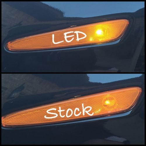

As mentioned in the chat, a local corvette guy was getting rid of his LED side markers (got clear instead of smoked) so was letting his smoked LED markers go for $40 so picked them up.
For reference, OEM side markers light up like this - both front and back - just a small bulb in the rear, rest is reflector.
This is what mine looks like after the intall - took about 15 min total.
Top - OEM
Middle - LED installed
Bottom - LED light up
Top - OEM

I like them
Re: This can only end poorly
Wait till you see it at night. It's adds a pretty dramatic effect to the car.

Lights off in garage.
Curious how it will look outside at night.

I still kind of like the smoked.
