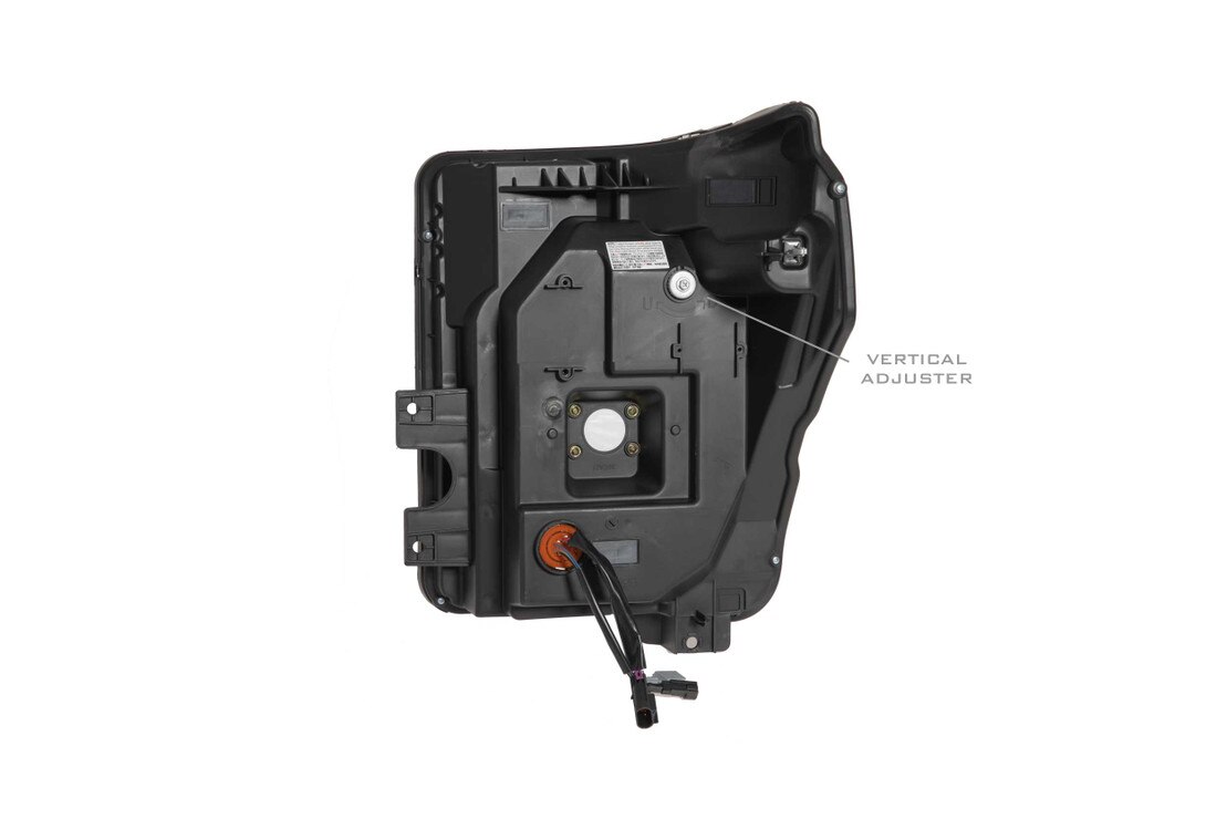

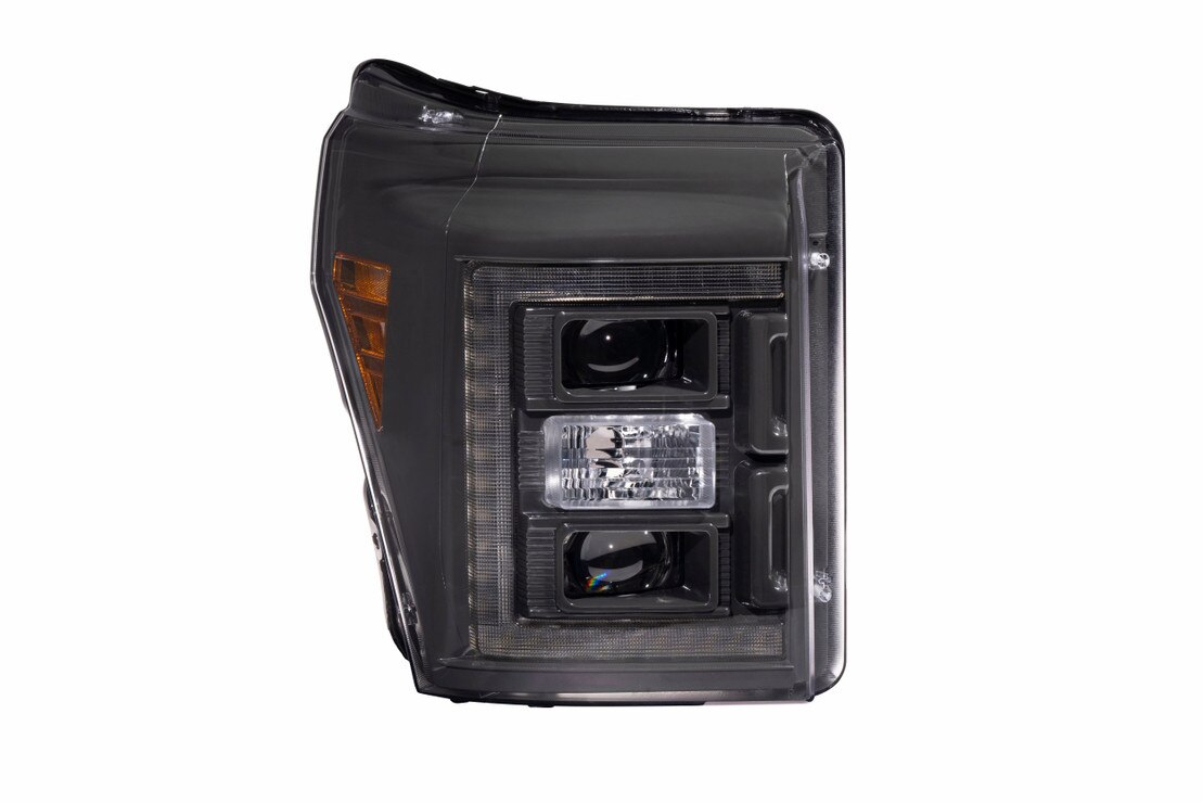

Mentioned this in shout or chat or whatever it is called now. But the lights I received are different than what is advertised on the website. Haven't had a chance to contact them asking but it looks like they updated their design or something?
What is listed on their site and looks same in their install video:
What I received (box says hybrid):
Going to try and install these tonight and see what they do/how they look and go from there. Might just be an updated design? Doesn't look like anything I can find on their site for trucks.

Got them installed. Need to wait for nighttime to adjust them if needed. I will probably do it in a couple of months when it is darker sooner or wait and do it one evening late. Simple set up is at 25 ft away, center of light should be at or right below height of headlamps and equidistant apart from center line. They will be a PAIN to adjust as I will need to remove everything again that I took off to put them on. No good access to adjustment screws. You can see them from up top, but no idea how the hell I would get a screwdriver in there at the right angle.

What the hell. Did they do a gen 2 hybrid or something? My understanding was the hybrid was LED everything except the turn signal. That's what's in your first photo and it just reuses your existing incandescent turn signal. Hybrids are cheaper because they have fewer main LED lights and no turn signal control electronics.
But they're not full XBs. Those have 3 big projectors down the middle.
They look awesome though. It's definitely a win.

It was definitely a complete surprise when I opened them up.
That and the sequential turn signals is a nice upgrade. These should definitely be more than the original hybrids. Almost wonder if they sent these by mistake? :lol:
