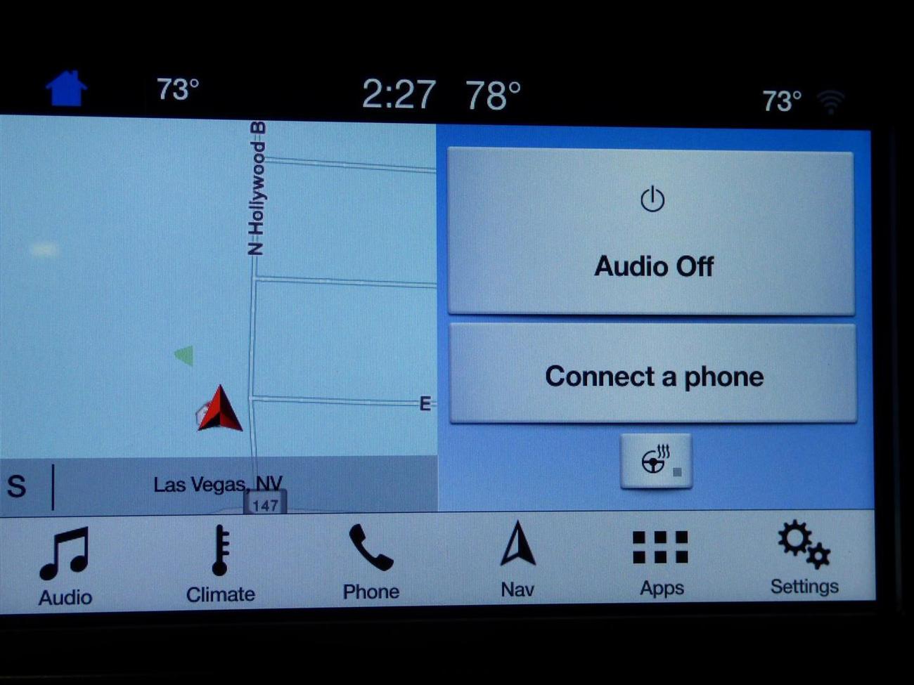

Yeah on the Explorer, you can have the heated steering wheel, heated seats, and cooled seat buttons on the sync home screen. There are physical buttons for the heated/cooled seats, but not the steering wheel.
Re: Let's try Ford now.
Sync software is the same across everything, so I just need to find the setting for it. I'm going to have to make a bunch of other changes when I swap the dash, so I'll worry about it then.
- Posts: 9890
Yup that's what hers looked like. I added the buttons for heated/cooled seats on that screen (basically makes a full row across the bottom where the heated steering wheel button is) because it just made the home screen look more complete
