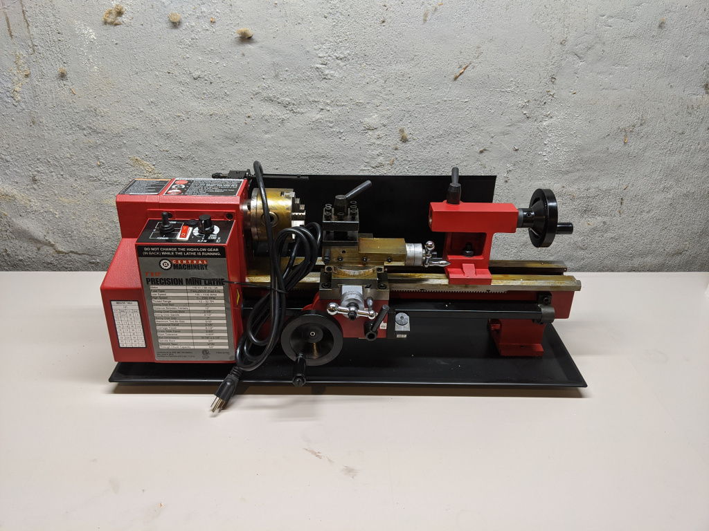

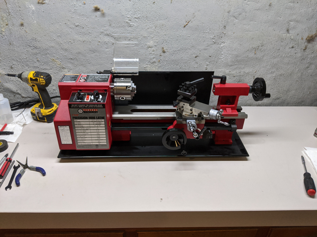

For years I've mulled around picking up a desktop metal lathe and finally pulled the trigger. I wouldn't mind something a little bigger and nicer but for the price and what I will realistically do with it, the Harbor Freight Central Machinery model is fine.
Some of you guys probably have machining experience but I've only done a little doing grunt work for my college's formula team. They don't exactly accept a Computer Science major very easily lol. My dad was a toolmaker for over 35 years at a govt arsenal so I figure, it would be a fun to learn from him.

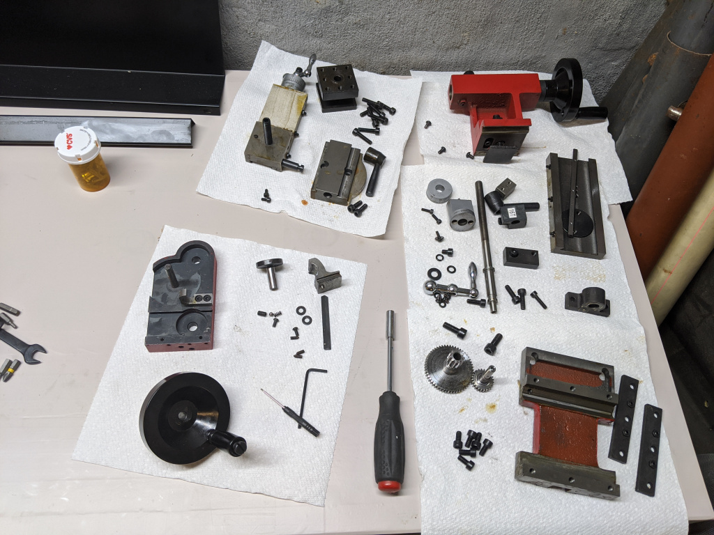

"They" say when you first get the machine to tear it apart and give it a good cleaning to remove the storage grease and tune the gibs etc. So I picked up a parts cleaner bin and went at it. Glad I did, sooo many manufacturing shavings in the sliding bits...

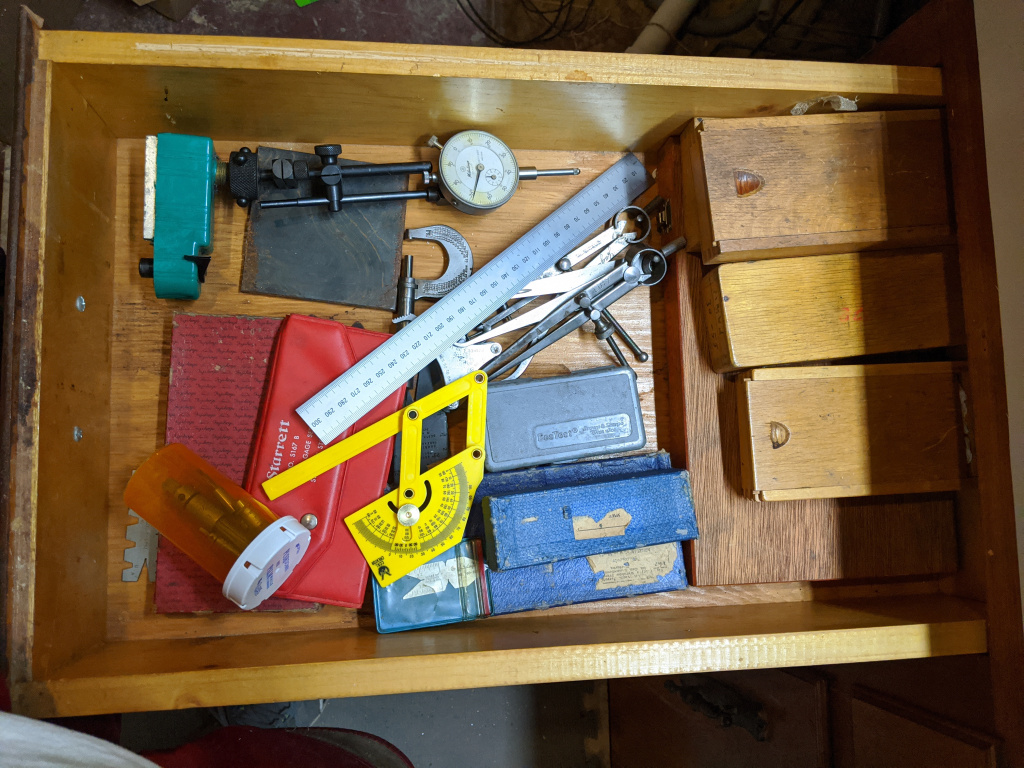

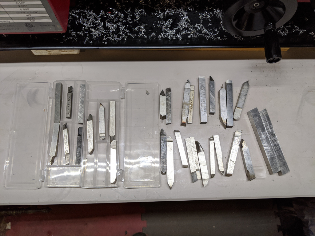

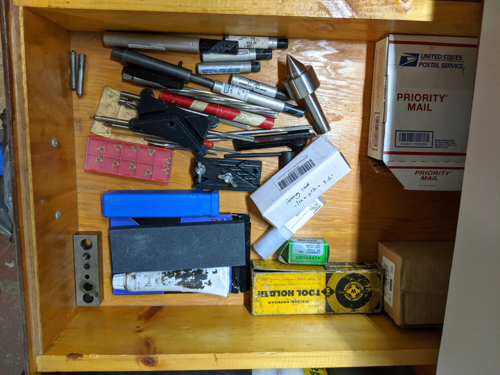

My dad has accumulated a ton of machining tools so he gave me a bunch of whatever he had lying around. HSS bits, drills, calipers, micrometers, etc. Even a nice $300 Jacobs keyless tailstock chuck :D Overkill for this machine haha.

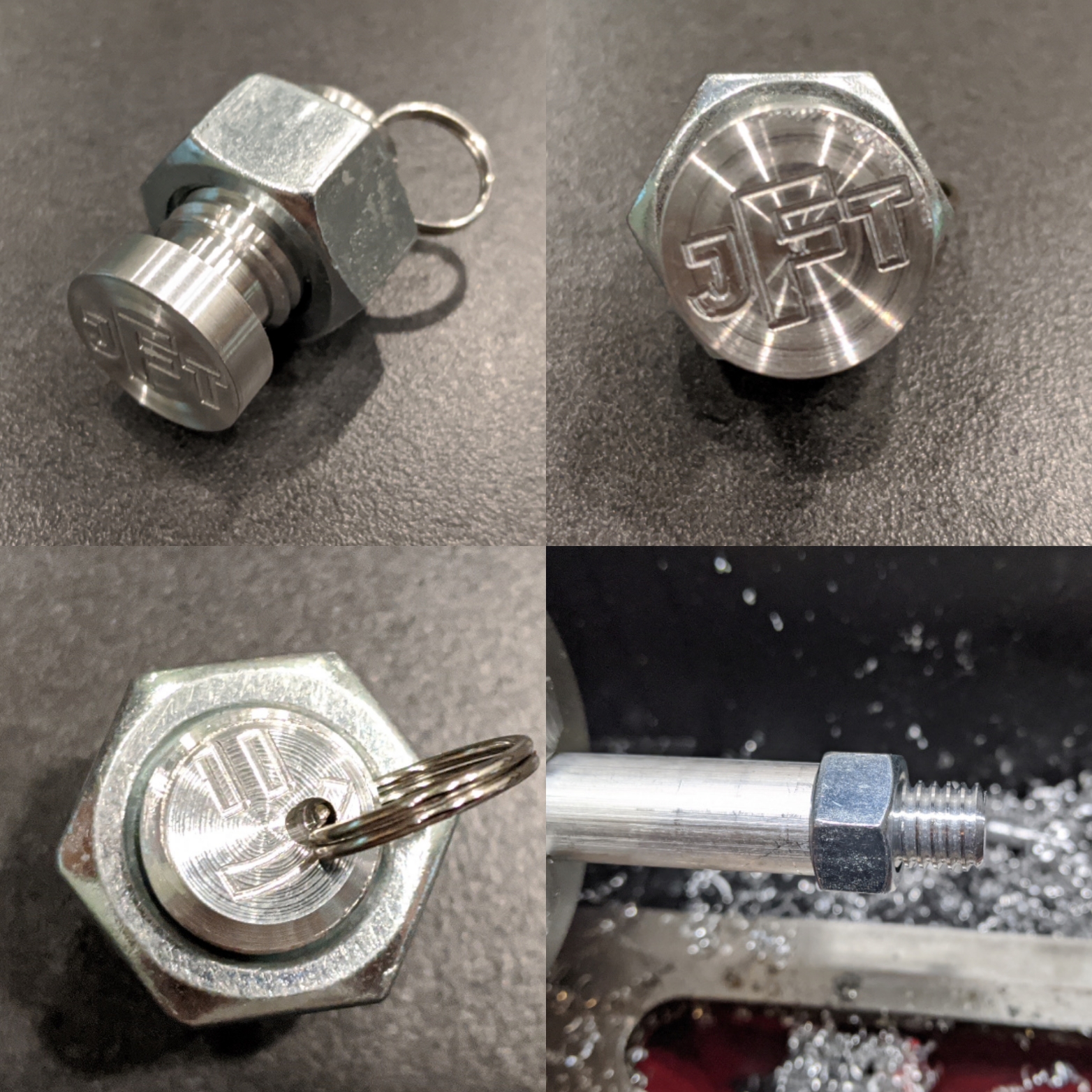

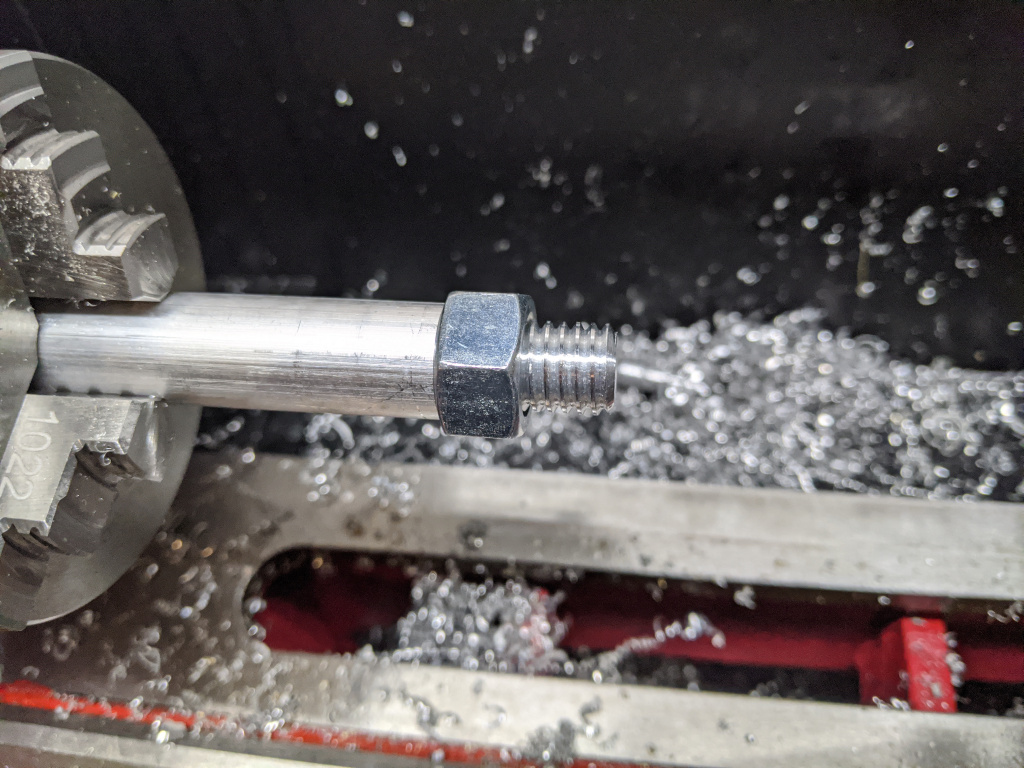

After some basics, went through doing some threading as it's a bit more complicated that just turning diameter down.

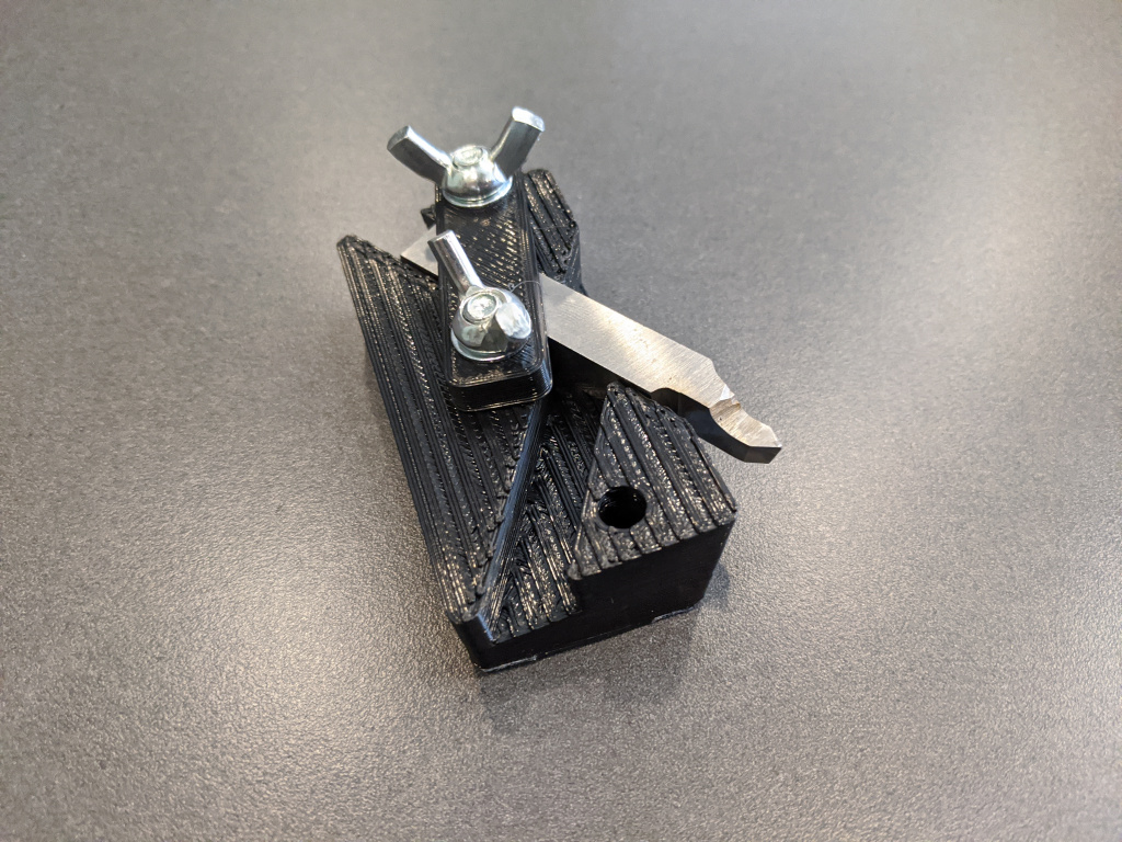

The 60 degree threading tool needed some sharpening, so I designed and printed a grinding jig to make it easier to grind the side angles and end relief.
Here we go, first thread.
I needed to commemorate this somehow. Got the idea to make a fidget widget keychain out of it and CNC Mill out my buddy's monogram as a gift for helping me lift it on the table.

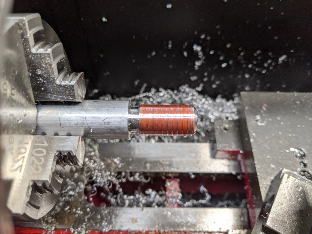

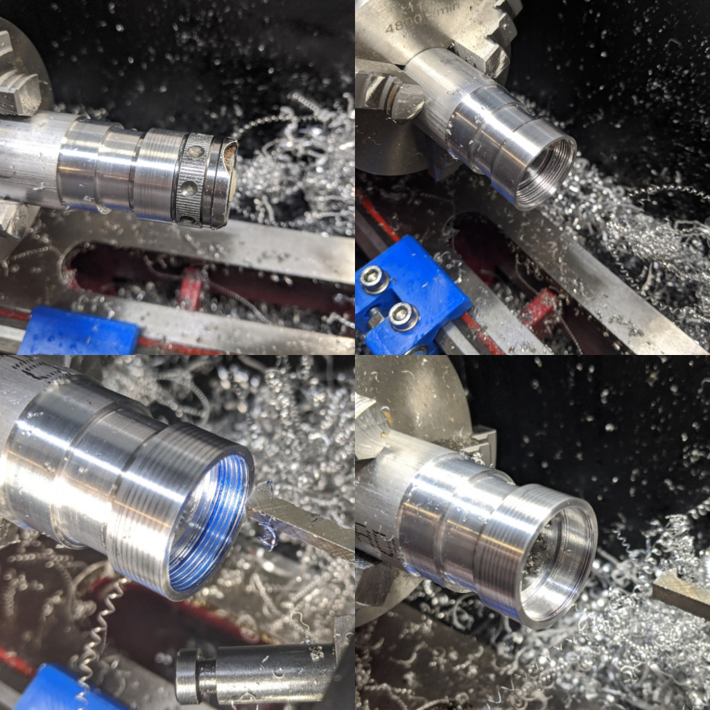

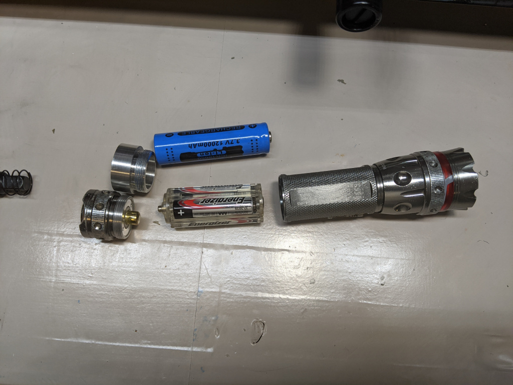

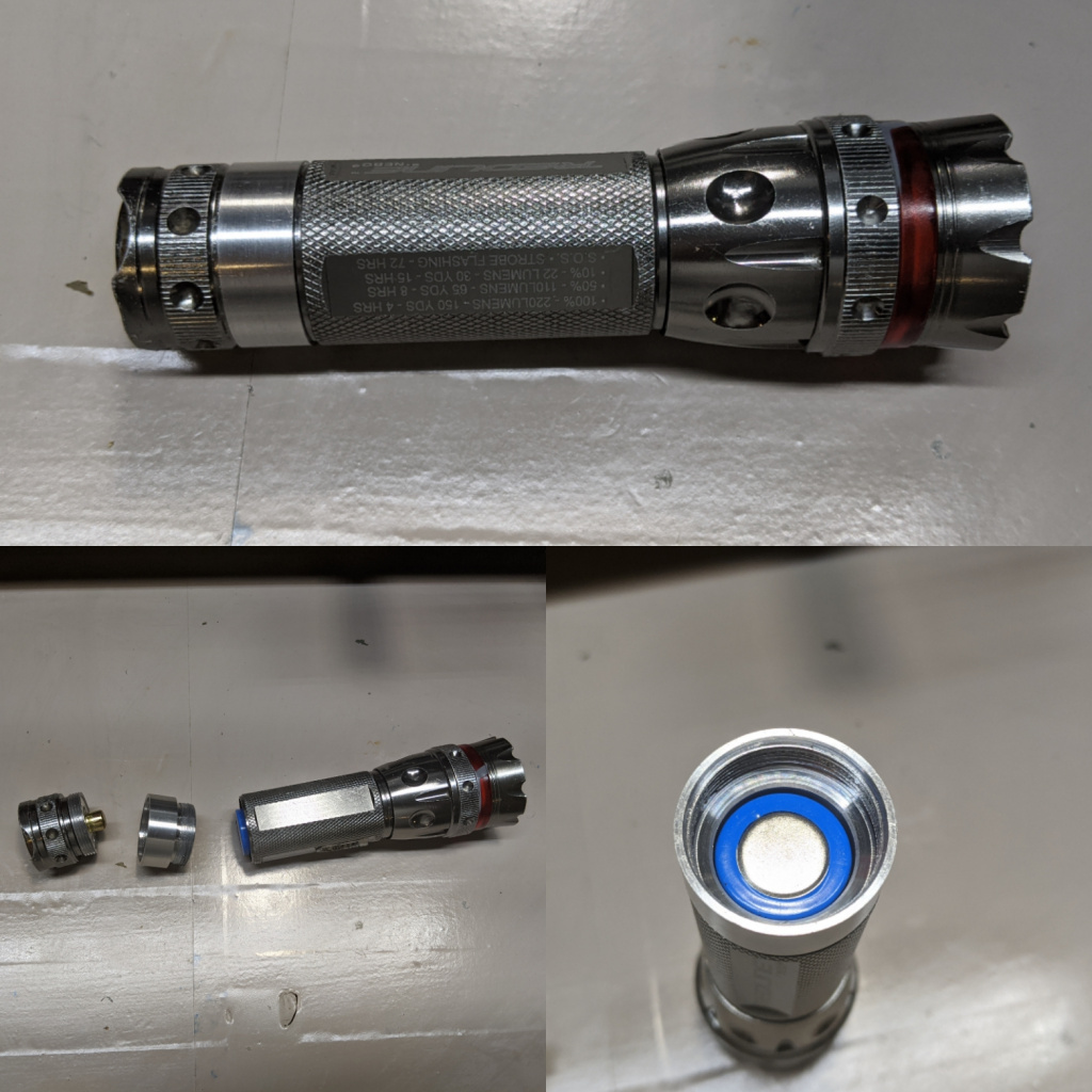

The next project I had in mind to practice with is a bit more useful. I've wanted to extend a few of these Nebo flashlights I have to use standard 18650 rechargeable batteries instead of a 3xAAA pack. I actually printed one but realized(way after) that it needed to conduct lol.

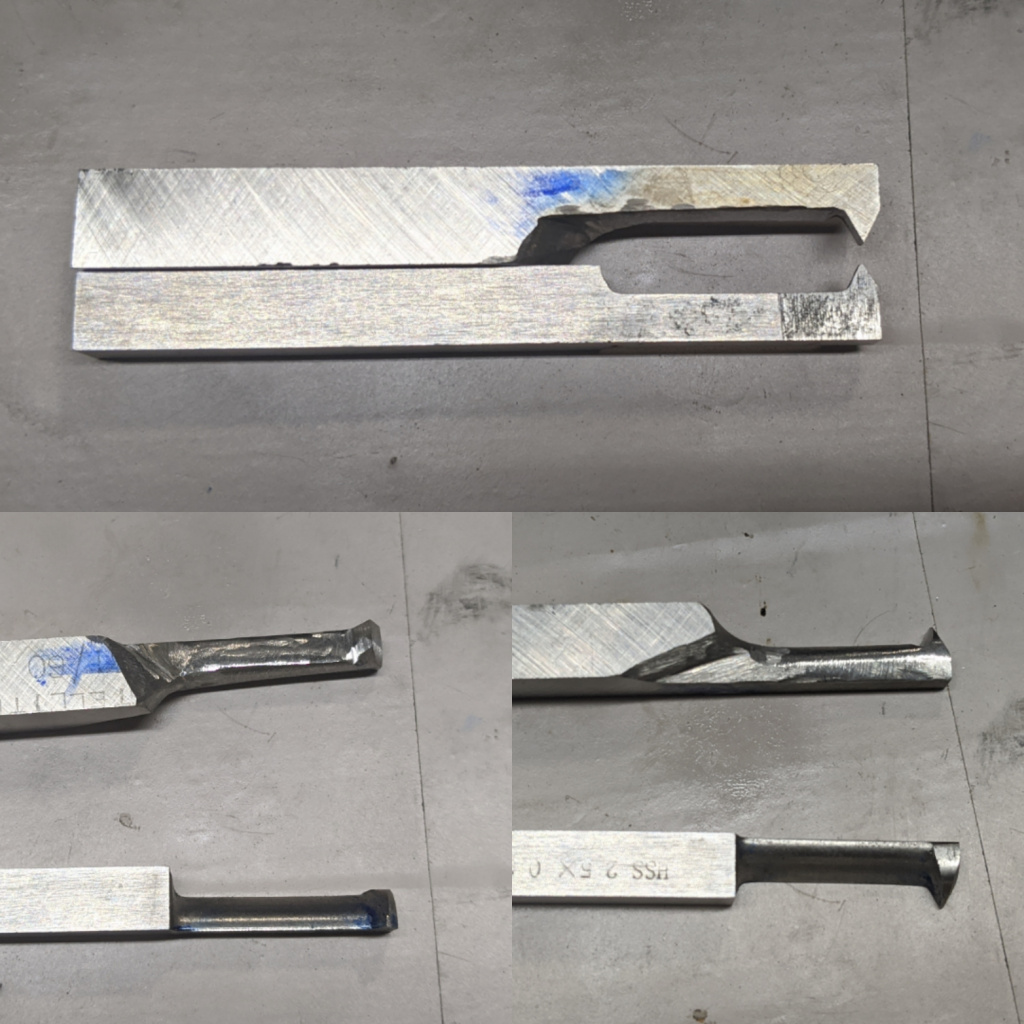

This adapter turned out to be a little interesting for a first project which is fun! I first needed to confidently thread the inside up against a shoulder. So instead of threading toward the stock, I ground a left internal threading tool bit so I could cut the threads in reverse. Spent a lot of time grinding but it came out and worked great.
Here it is next to a right tool I bought.
I made the adapter completely without removing it from the chuck. That took a bit of planning which took drawing a few pictures but eventually got it figured out.
It works! Although, the M24x1.0 was a bit tough to cut, I may need to tighten some more stuff up and sharpen my bits a little bit better to single point cut sucha thread.

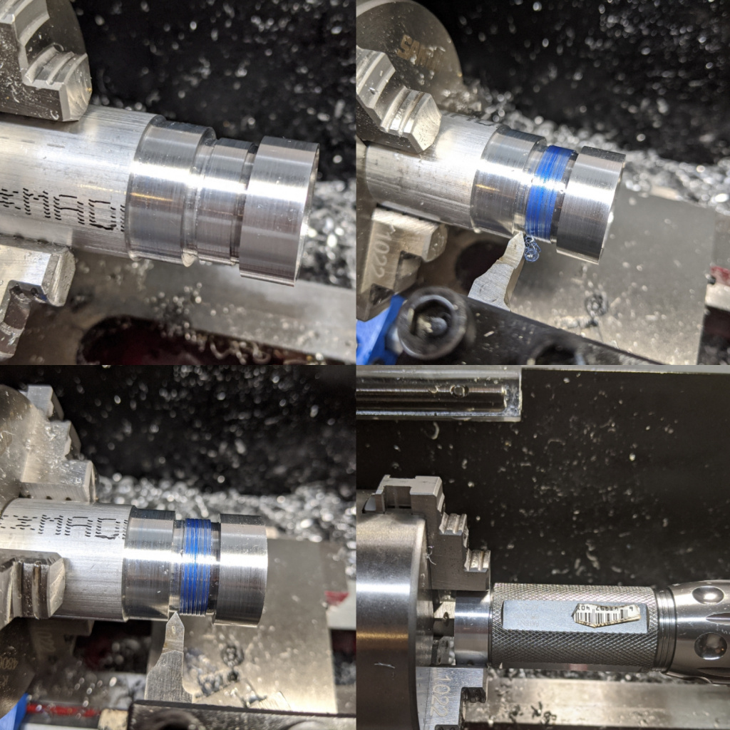

Nice work. How did you do the threads?
Re: Turning tricks
[quote=""ChargerX3""]Nice work. How did you do the threads?[/quote]
Are the pictures working now?
Not sure what level of detail you are asking about but I used 60degree HSS threading bits to do single point threading. One I ground myself and the other I had. As opposed to a tap and die.

The lathe still has ratios to set for the speed and how fast the cutter moves, and the cutter will move when engaged, you just adjust the cutter speed for the thread pitch. The thread size comes from the major diameter, and minor diameter. The angle of the threads (at least for UNF and Metric) is always 60°.
Typing it out, it sounds simple, but it really takes a lot of practice and patience to get right.

This for sure *100 lol. Even once you get the basic "how" the machine can do the timing, I learned that there are a few ways in the procedure to cut a thread on a lathe. This is apparently a very debatable thing, akin to which oil threads lol.
Then you get into the engineering aspects of a thread and there are different tolerance levels, essentially, on the farm vs outer space lol. I was able to make an M24x1.0(this is probably considered an "extra super fine thread" or something lol) that fit the part I have on hand. In order to make it work well with another M24x1.0 part from a different shop, I would have to pay attention to a lot more detail and measuring to ensure a proper fit.

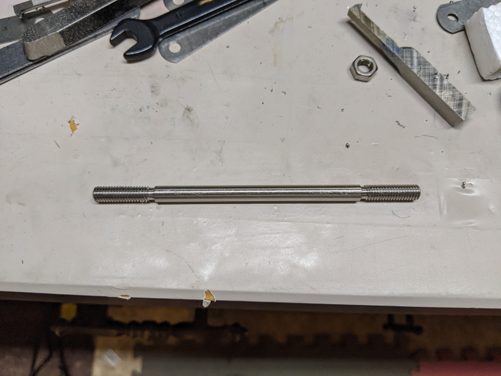

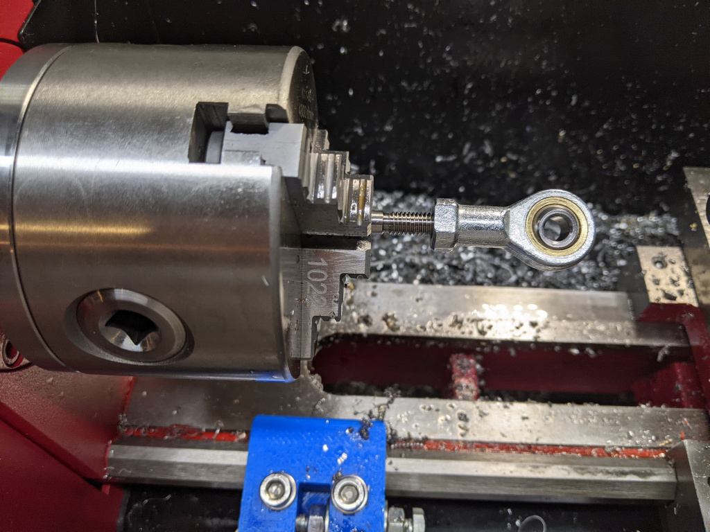

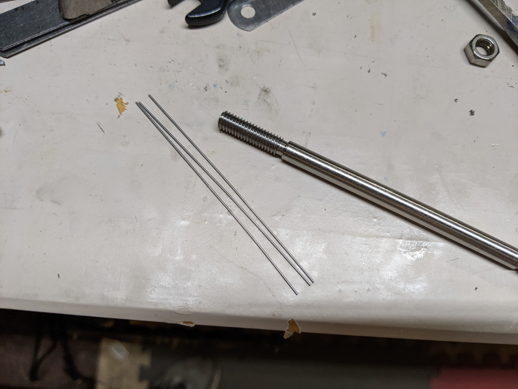

Tried cutting some stainless steel for the first time. It worked ok, it's much harder than the AL I was cutting before. This is for a linkage arm. I had issues with it being too thin and flexible and can't use the live center to support it because it would be in the way.
Since this isn't going on a space ship...I just pressed a brass bar against it so to prevent the deflection during threading.
I didn't actually intend to do this on the lathe with single point threading. I thought my dad gave me an m6x1mm die but alas, he did not.
end result
I also tried out using thread pitch gauge wires. You put these in the threads straight across and measure the whole thing with a caliper. It tells you what your pitch diameter is to compare to the spec of the thread size. It basically just uses circles and triangles/maths to figure it out but simplifies it to a measurement followed by subtracting a constant provided from a chart.

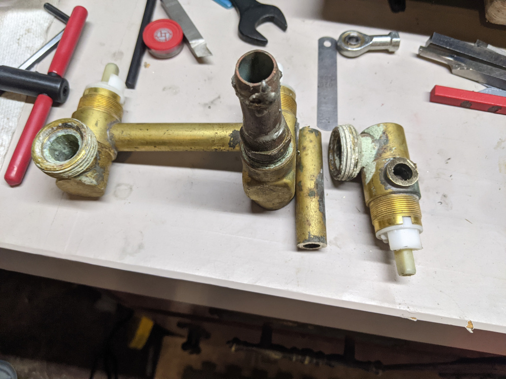

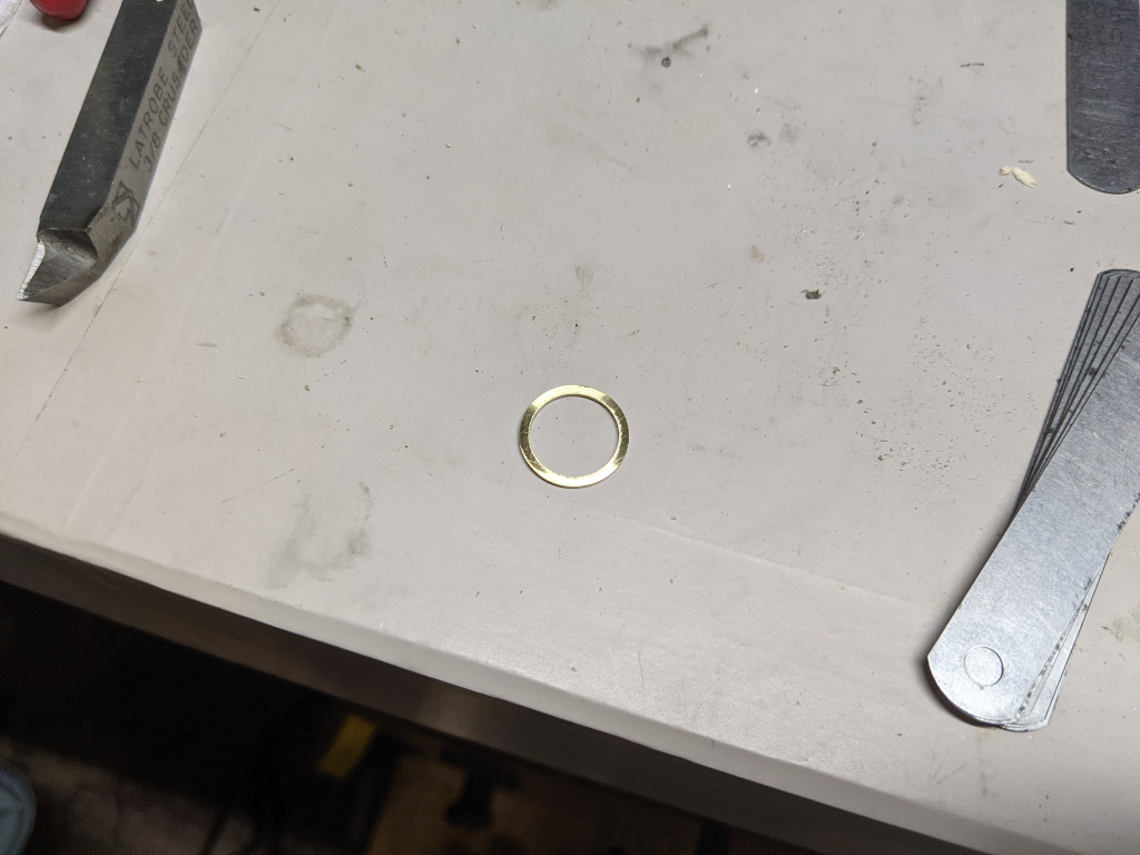

Oh I also had to machine out a brass bushing sliver because the leadscrew had too much backlash and I couldn't adjust it far enough to make it tight. I used some old plumbing I ripped out of the house :lol:
